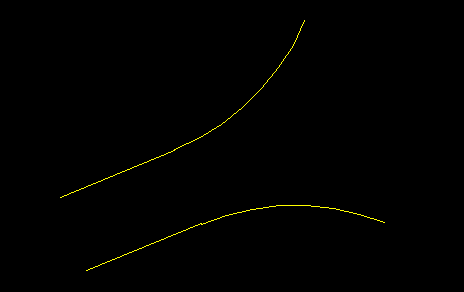

Good day to all of you, my question is as follows:
Is there any form to offset a line from a base, but one line in any given distance and the other in another given distance?
Thank you very much in advance for your help.
