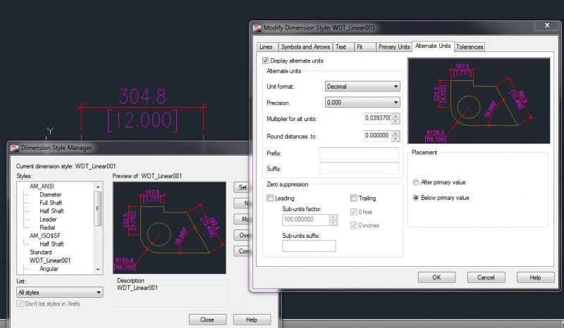

Personally, in that case, I'd use a dimension Style with the Alternate Units set.
... even if it meant having to change styles programmatically you'd be in front because the dimension would retain it's associativity.
An alternative would be to apply dim over-rides to the specific dimensions you wanted to display with the Alternate Dimensions .. again retaining associativity.
Another alternative to programming a solution is to dim-override modify one dimension manually ( you'd need linear and aligned) then simply use MatchProperties to apply the settings to other dimensions
a piccy:
The alternate units won't work in this case. The drawing is not to scale and all dimensions are put in with text overrides. I have been able to achieve the results I want with the base that Lee started me on.
