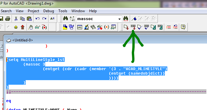

Sorry I don't understand your comment
You don't need a defun to test.
In the VLIDE simply select a lisp statement and press the 'Load Selection' button
Like this:
