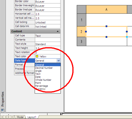

NBC Posted August 4, 2010 Posted August 4, 2010 What data type is the cell you are trying to type into ? Quote
Tiger Posted August 4, 2010 Author Posted August 4, 2010 Some added information; I type 50/140. I hit enter and a dialogue box shows up asking if I want to enable AutoStacking - if I untick it or not, it doesn't matter, when I leave the dialogue box (either by Cancel or OK, doesn't matter) my 50/140 have turned into 1/4. And if I go into the cell again, the 1/4 disappears and it shows 11703/32768 instead. So perhaps auto-stacking is not the issue? What data type is the cell you are trying to type into ? Its a Header type? I can't find another type to give you... Quote
NBC Posted August 4, 2010 Posted August 4, 2010 Data Type of the cell can found by selecting the cell, and opening up the Properties Palette. Under the heading Content, there should be a Data Type, see picture: Quote
Tiger Posted August 5, 2010 Author Posted August 5, 2010 Data Type of the cell can found by selecting the cell, and opening up the Properties Palette.Under the heading Content, there should be a Data Type, see picture: hawt dang it, you solved it NBC! If I the Data type to Text it displays it like I have typed it, thanks a bunch! Now where is that setting in the Table Style.... Quote

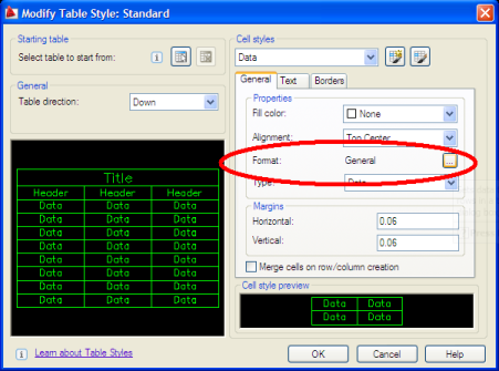

NBC Posted August 5, 2010 Posted August 5, 2010 hawt dang it, you solved it NBC! If I the Data type to Text it displays it like I have typed it, thanks a bunch! Now where is that setting in the Table Style.... From the Table Style Dialogue Box, when you click on Modify, you get the picture below. Check what the Format is set to: Quote
