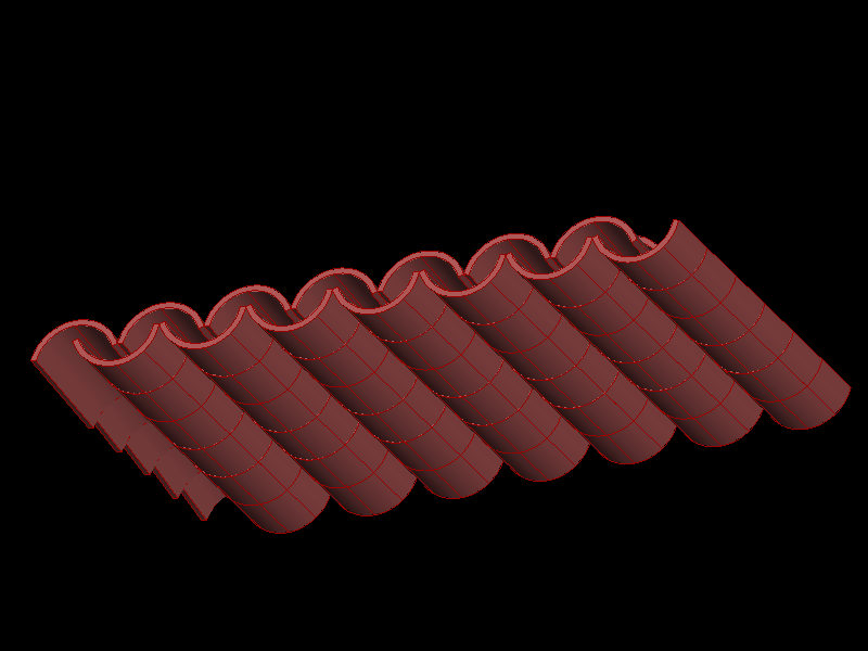

I just got myself in a world of hurt. I have a client that is requiring me to make an 80x120 hipped free span horse-riding arena w/ life like rendering. I have designed the structure but the client wants to see Spanish tile on the roof. I have used 3d solids for the entire structure. My question is there a way to place a 3d tile roof on my model simply or do I have to copy and paste tile I made over the entire thing? Anything better than messing with 2 million some tiles. :cry:

:ouch: Ugh, that's the worst type of roof to have to deal with in 3D. You could try using a texture with a bump map, but that just never looks very good in my opinion. The only way to really do it right is to model it. I would suggest doing like a 10x10 section of the tiles, make a block of that section and then copy and paste it around to complete the roof.
Thats what I was afraid of. Guess I better start now. Thanks for the input.
I would model a single tile first than use combination's of "copy" "rotate" and "array" to get the roof laid out. You can overlap and slice for the corners.

Thats what I did. after I had 1.4million tiles my computer started crapping out. I think I have to create 3 tile tall bay to bay section solid to reduce file size. The file was over 72mb.

Yes, that's why I suggested making a block of a 10x10 section of the roof and then copy and paste. You don't want individual tiles. That will kill your performance.
