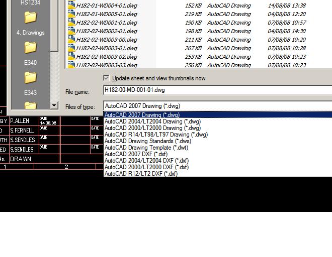

Tiger Posted September 9, 2008 Author Posted September 9, 2008 But can you actually save to a 2005-format?? I can't save down to 2005 from my 2008-copy... and per default it saves to 2007-format. Quote
dbroada Posted September 9, 2008 Posted September 9, 2008 That is correct. The format only changes every few releases. They are 2 different things. I cannot verify the above but I have used it often enough over the years to expect it to be true. Quote

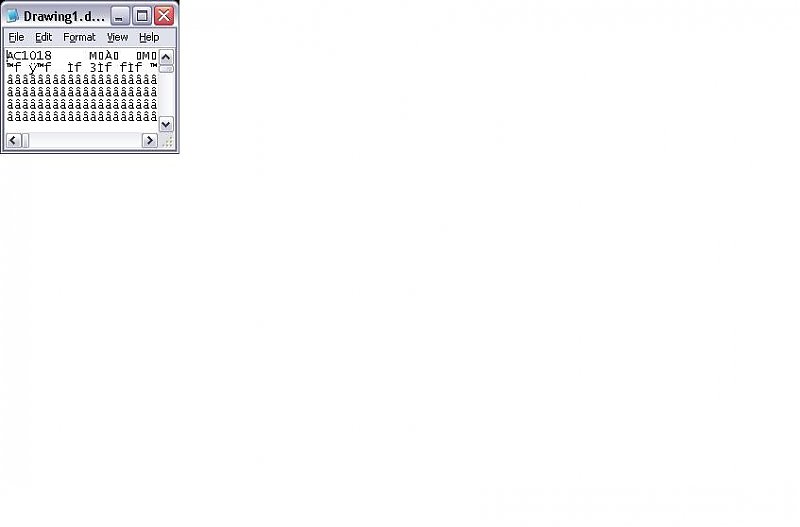

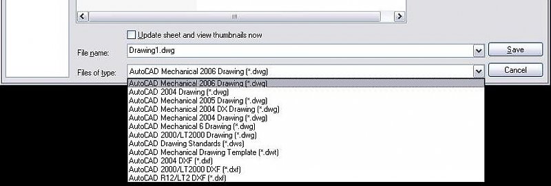

GE13579 Posted September 9, 2008 Posted September 9, 2008 I have all manner of save options- 2006, 2005Mech, 2005... I just saved to 2006 and my Notepad file read AC1018. Quote
dbroada Posted September 9, 2008 Posted September 9, 2008 I have all manner of save options- 2006, 2005Mech, 2005... I just saved to 2006 and my Notepad file read AC1018. that is correct - it has saved it in release 2004 format. There is no such thing as a 2006 format. Quote
GE13579 Posted September 9, 2008 Posted September 9, 2008 Yep I thought that was the case, just wasn't too confident about it. Cheers Dave! Quote

Tiger Posted September 9, 2008 Author Posted September 9, 2008 Not sure I've read such a pointless thread on here for some time And that helped how? The question came up, we're trying to answer it, and forgive me if I'm finding it a bit hard to understand and need a bit more clarification to understand GEs comment. wait a minute GE - you are saying you can do a Save As and choose "AutoCAD 2005" as the format? That is what it says in the drop down list where you choose from? But it's till 2004-format just that it's called 2005?? But then we need to keep all the different format-options - or keep them, and explain they are the releases, but the format is the same? Quote
dbroada Posted September 9, 2008 Posted September 9, 2008 I think GE must have an extended list as mine only gives me the option of 2004 & 2007. I think you (we) need a way to differentiate between releases and format. Once that is grasped the rest falls into place - or at least it does for me. Quote
Tiger Posted September 10, 2008 Author Posted September 10, 2008 hmm... but I notice that you only have 2000 and 2004 as the pure AutoCAD formats - is there something special about the Mech-formats? Quote
GE13579 Posted September 10, 2008 Posted September 10, 2008 I don't know- I'll save down to Mech '05 and see what happens in Notepad... Quote
NBC Posted September 10, 2008 Posted September 10, 2008 These intermediate file versions should be forgotten about imo. Let's stick to what the majority of users will be able to see / accomplish; i.e. the list in Tiger's initial post on this thread. Quote
dbroada Posted September 10, 2008 Posted September 10, 2008 Is there any difference between a mechanical file and a vanilla file? More accurately, has there ever been? If not it looks like padding, make you think you are getting something special. Quote
