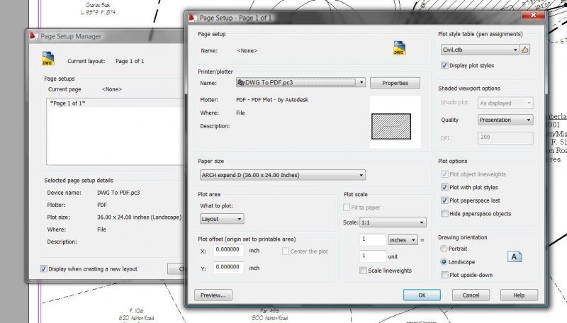

When I scale a viewport, I don't use the zoom 1:100 thingy.
I simply set up the page layout as shown then viewport properties in the Properties box as shown. Notice the Plot scale is 1:1. Are you changing that? That controls the size of your entire page in relation to the paper size.
Thanks Dana,
Your answer actually solved my problem - thanks for your effort and the included screen-shots.
