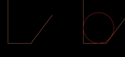

My mind might be a bit blank. How do I draw a circle that touches the three lines. IE, I have the figure on the left and I want the figure on the right. Accurately.
If it matters, two of the lines are orthogonal.
Thanks
Using Xline bisect the 2 angles
Draw a circle centered at the intersection of the 2 Xlines and a radius Perpendicular to one of 3 lines
Or draw a circle with three points, and the points are tangents to the three lines.
