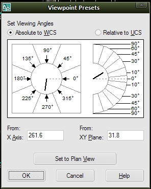

A coworker wants to set up a custom DDVPoint button. He wants it to use preset values for the X axis and the XY plane. What do I need to put in the button macro to achieve this.
Macro:
^C^C_vpoint;
Any ideas? I am sure that I call out "A" for the X axis and "P" for the XY plane, I am just not sure how.
TIA
Sean
Never mind, I figured it out.
^C^C_vpoint;r;245;20;
