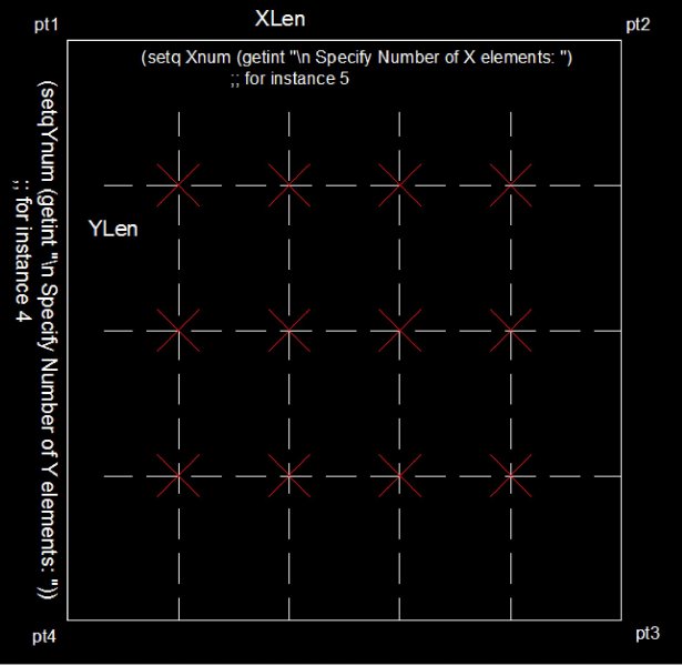

Suppose that I have a room and I want to divide it into specific points.
My codes are running well up to the crossing points. I mean How can I support
the X and Y for the divided points at X and Y as well ?

The crosses in RED are what I would like to get. Although these points
are would be changed according to user input.
Many thanks
Michaels
