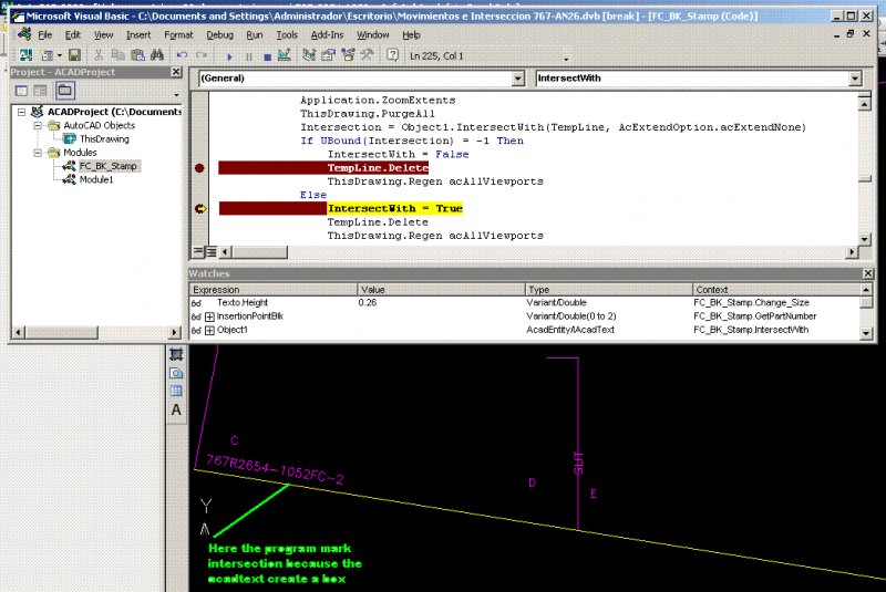

Here is the problem. I create a program for increase the size of text, Text.Height
Now the text sometimes intersect with other objects, when this append I take the Text.Insertion point and move a little up, down, left, right, and review with command intersectwith if the object text intersect with other object on drawing.
But some times the Intersectwith give me a False intersection, for example if I have a text with 6.13 degree of rotation the program give me a intersection with text 767R2654-1052FC-2 False Intersection.jpg
A false intersection, The autocad create a BoundingBox around text but this box not considerer the text rotation, the box is not on angle of rotation like a box create with QTEXT command, I need a Box like QTEXT, but Qtext is imposible to get and use for intersectwith. Maybe a polyline like a QText box.
Now I need a box around the text for review if the text intersect with the yellow polyline. I need to do this for 7894 dxf drawings, I have a list of dxf drawings and path and autocad open file by file automatic and increse size and move the text with intersection but the problem is the false intersection. So I need a code for create a rectangle around the text, I try the command Qtext but I can't get the rectangle, I try to create Text.GetBoundingBox (MinPnt, MaxPnt) the result is a box on (0,0).

Perhaps this:
Angle = Text.Rotation
Set the Text’s Rotation property to 0.
Get BoundingBox.
Create LWPoly from the min and max.
Reset Text.Rotation = Angle.
Rotate the LWPoly, BasePoint = Text. TextAlignmentPoint, RotationAngle = Angle
Use LWPoly with IntersectWith
Thanks for your help, you are rigth.
This is a very easy solution ;-)
