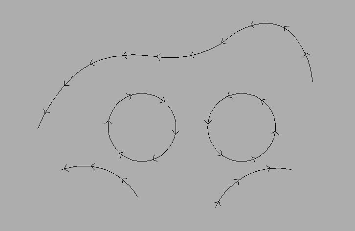

Or you could use a line type with the "greater than" or "less than" characters to show the direction.
This is good for Romans font, but for other fonts the Y dimension would have to be slightly adjusted to keep the arrow on line.
*ARROW_RIGHT,Arrow line Right---- > ---- > ---- > ----
A,.5,-0,[">",STANDARD,S=.1,R=0.0,X=-0.1,Y=-.0477]
*ARROW_LEFT,Arrow line Left----
