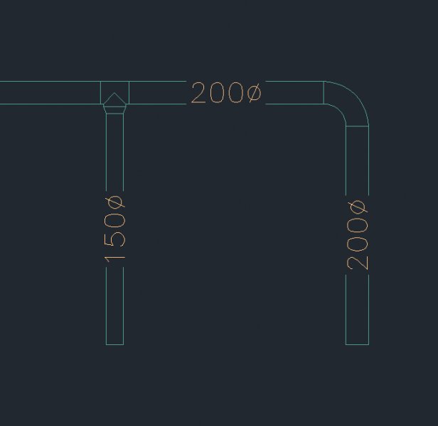

If you have a pipe or duct run in an L shape and you select a pipe and delete it, the bend connected to the pipe remains. I would like it to go with the pipe once I delete it. Is it doable?

Not quite. If I delete the 150 duct with tee and all, I'll be left with a gap in the main duct which needs dealing with. I guess I'm just spoiled as a program I used to work with would automatically close this gap. Would this be a Style Manager issue?
If you use a tap instead of a tee, it would work (I think). But yeah, just little issues like that I just deal with it... gotta connect the pipes back. :)
Although with pipe objects, it doesn't leave gaps that I know of. Duct, yes.
