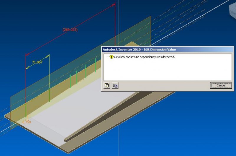

So I made the jump to Inventor and started working on a small project. I have had no formal training in Inventor, but had some training in Solid Edge several years ago. Still, I'm fairly confident that I can do the majority of what I want to accomplish. Now I've bumped into a problem that has me stumped to figure out the answer. Hoping someone could offer some assistance here.
I'm trying to draw a sketch that will represent my vertical post locations for a railing I'm designing, with the intention of using frame generator to create the 2"x1/2" flat bar posts. I have drawn some construction lines to represent the top and bottom of my posts, and have now drawn 7 lines that are going to be my posts. I've constrained the line that make up the left most post and did the same for the right most post. No problem so far. Now I need to evenly space the 5 lines in between. I drew a dimension of both constrained lines, the dimension is a driven dimension (d26) which is fine. I'm using it for a reference. I'm now trying to dimension the lines in between to give it the equal spacing I'm looking for. I add the formula d26/6 (take dimension d26 and divide by 6) and an error pops up that reads as follows: |A cyclical constraint dependency was detected."
First of all, what is causing this error message? I'm pretty sure I have my constraints properly set up (but I've been wrong before).
And second, how do I go about creating equal spaces for my vertical lines if I can't dimension it?
I'm making it so that if I need to change something to the structure, my railings will adjust accordingly, hence why I'm trying to reference a driven dimension.
Anyone able to help me figure this out?

Thanks for the suggestions. I will have to try both ways suggested and see what I learn from that. I managed to get the spacing done on my drawing, but had to place another driven dimension between fixed points in the geometry, and then complicate the math formula a bit by adding and subtracting the other 2 dimensions that constrained the lines at each end of the ramp, and then dividing the sum of those into 6. It's basically doing the same thing that I was trying to accomplish before, but for whatever reason, inventor accepted the new driven constraint but still gave me the same error when using the original driven dimension. Weird...
