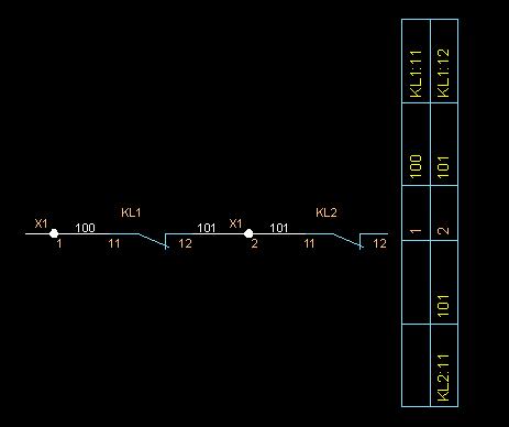

spakis Posted August 17, 2010 Posted August 17, 2010 Hi, I'm looking for some help on how to generate terminal strips from wiring diagrams. I'd like to write a macro in Autocad(autolisp or VBA) wich generates terminal strips I use terminal, contact and etc. blocks to draw wiring diagrams. I know how to find all blocks in a drawing, but have no idea how to determine connections and wire numbers between them. Any tips on how this could be done appreciated. Quote

spakis Posted August 17, 2010 Author Posted August 17, 2010 It should look something like this: from device from wire terminal number to wire to device. What do you mean by dynamic block? I have a block for single terminal, but i need to enter wire number and other data manualy it's quite time consuming and there is quite a chance of making a mistake, so i'd like to auomate this process. Quote

SteveK Posted August 17, 2010 Posted August 17, 2010 It should look something like this:from device from wire terminal number to wire to device. spakis, are these text inputs that accompany each block? If so then you might be better off creating a block with tags, then use a lisp to collect the blocks and somehow increment numbers in specific tags. Post a picture if you can. Quote
spakis Posted August 17, 2010 Author Posted August 17, 2010 Oh, i've been using dynamic blocks before, but that doesn't solve my problem. This is a example circuit: What i'd like to know how to programaticaly find out connections between terminal X1-1 and KL1-11, KL1-12 and X1-2 and so on. I also need to get wire numbers of these connections, but i can't come up with solution. Quote
SteveK Posted August 17, 2010 Posted August 17, 2010 Ok, so obviously you'd use AutoCAD Electrical as ReMark suggested if you had it so we'll rule that out (though if you do this offen maybe you should think about it). What i'd like to know how to programaticaly find out connectionsbetween terminal X1-1 and KL1-11, KL1-12 and X1-2 and so on. Yeah I'm not sure how a custom lisp could come up with the value (eg) 100 between X1-1 and KL1-11, unless it retrieves it from that table you've included in the picture - which would be difficult if the table can not be collected into a list. Not a great solution, but if the values X1, 1 and 100 are tags in the block, then a simple lisp could be made to increment the number in that tag when a block is selected, but that's not hugely helpful.. Maybe someone else has an idea. Quote
