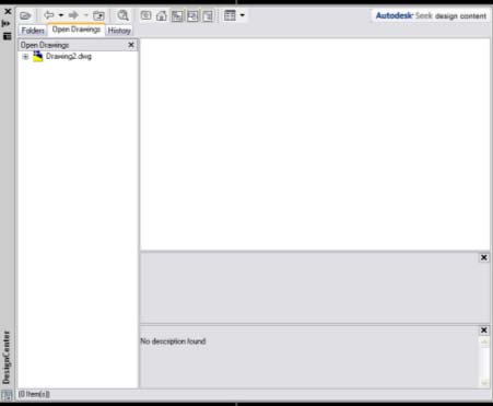

bassmaster_m Posted August 18, 2010 Posted August 18, 2010 Hi ancoursey, It sounds like the easiest option for you might be to use the AutoCAD Design Center feature. Try the following: -Start by opening the drawing that you want to use as your "base" drawing (into which you will insert the others). -Type "dc" to start the command, this window shown below should pop up. -From here you can navigate to each of the drawings you want to incorporate using the "Folders" tab at the top left. -When you click on one of the drawings in the navigation window a bunch of icons will appear: "blocks", "layers", "layouts", etc... Double click on the layout icon. -You will see an icon for each of the layout tabs in the drawing listed by name. Double clicking on an icon will insert this layout and any paperspace data that it contains into the "base drawing". -Repeat this for each of the drawings, until all of the layout tabs are contained in the one drawing file. It sounds kind of tedious but it's actually pretty quick. As for the model space content, I believe you will either need to copy/paste or use x-ref's, as rkent suggested, and then reposition the viewports for each model tab. Maybe someone has a better way, but this is most likely how I'd approach the issue. Hope this helps! -mw Quote

ancoursey Posted August 23, 2010 Author Posted August 23, 2010 Bassmaster, When I type in 'dc' it asks me to 'specify center point of text'. Is Design Center on AutoCAD Mechanical 2010? If so, is there another way to get to it? Thanks Quote
bassmaster_m Posted August 27, 2010 Posted August 27, 2010 Hi ancoursey, Sorry for the late reply, I was out of town for a few days. Looks like you got a couple of responses already though, how are you making out with this? Is the design centre feature helping at all? -mw Quote
