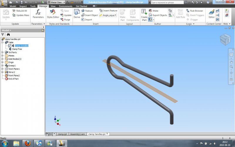

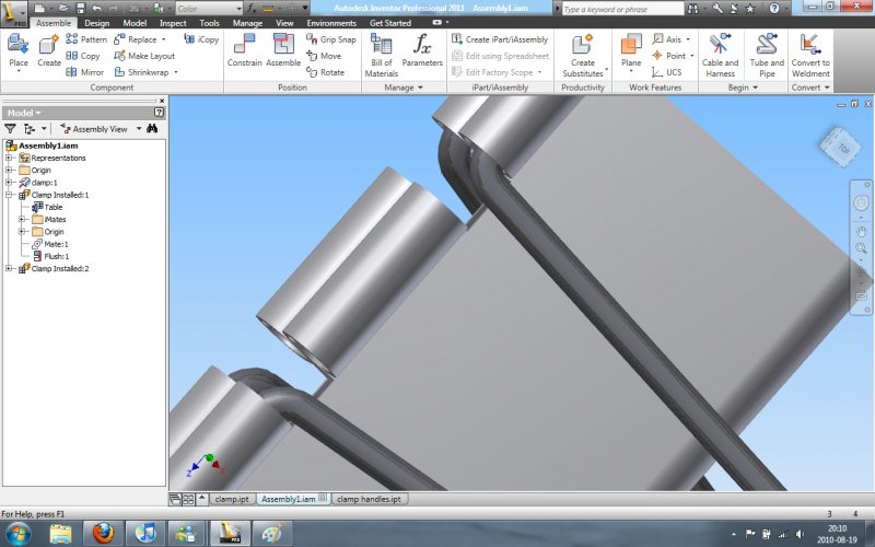

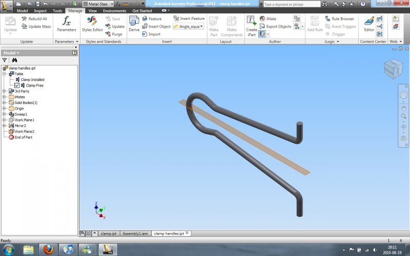

dgaudreau Posted August 20, 2010 Posted August 20, 2010 I did get an error opening the first file but I was able to open it. Anyway, I am not sure if it would be a good idea to use the ipart function. I just tried it and it does what you wanted but some people might that it would be the wrong way to do it. Here are some pictures: to make the ipart, I had to constrain a little bit more your path sketch for the clamp handle. Quote
