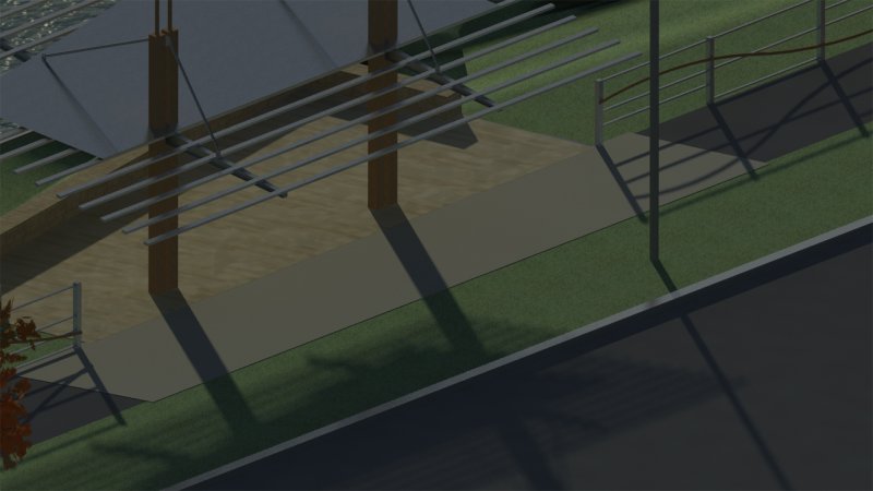

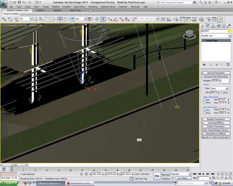

Ok so I am using Mental Ray Photometric daylight. All is well I have positioned the sun in a spot which I think will set me up for a good semi night lighting effect.
The only problem is my spot lights will not work while my daylight Mr Sun thingo is in place.
As you can see the spot light multiplier has been increase up above 50000 and I can see it in the viewport, so why wont it render?
thanks in advance,
Funk

Mental Ray Photometric daylight? What's that? :?
Do you mean the Daylight System? You're not using a Photometric light as your sun are you? :unsure:
Can you post more information about the type of lights you're using, as well as your render and environment settings? I am unable to duplicate the problem you're experiencing. :unsure:
hey mate, thanks for the reply I was using daylight environment settings as in Mr Sun and Mr Physical Daylight (i think its called) and normal omni and spot lights which wern't showing in renders.
I read in a post that you had a while ago that you need to use 'Mr' lights? and jack up the multiplier to see them during Daylight environments. I wanted to have the sun at about 7pm (so like dusk lighting) with soft lighting effects within the shelter. I havnt been at work so been unable to reply.
But what I ended up doing was just placing a soft spot light (turning off daylight environement) to replicate the night lighting, using just a dark blue background colour, and using normal lights, which worked well, but was trying to use the Daylight environment settings with lights, is that possible?

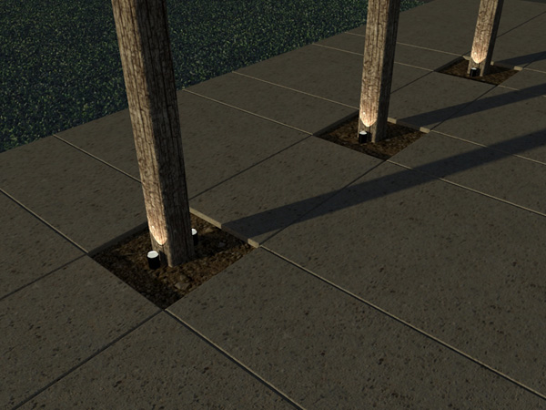

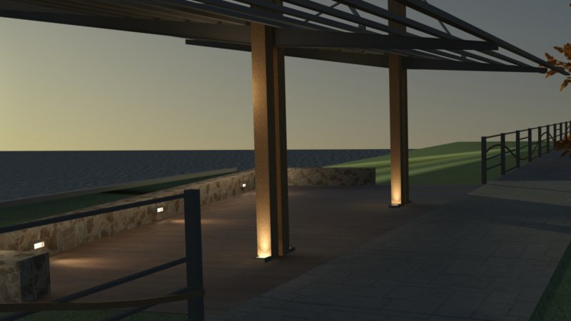

I played around with this a little bit today and the render below is what I got.
I used the daylight system for sunlight and I placed photometric lights at the base of the posts. I set the "Light Distribution" to "Spotlight", used the "Halogen (Cool)" color preset and set the Intensity to 50000 cd.
Give that a try and see what you get.
There are so many questions I would love to ask about that render.. =) for instance your bump mapping, but as for the lighting your advice was great. I had never used photometric lighting. Worked very well. I had to use standard lights to sort of GI the shelter though as my boss thought that the up lights weren't enough.
I put rectangle photometric lights in the fittings to create they glow of the bulbs, and then the photometric spotlight which you suggested for the up light effect.

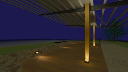

here is an image of my result at 6pm.
The only thing that bugged me was I tried to make the support uplights light up the bottom of the roof, so I upped the multiplier to reach it, but then the light looked to bright down the bottom, So I ended up just putting omni's under the roof.
Did you try adjusting the spotlight distribution "Hotspot" and "Falloff"?

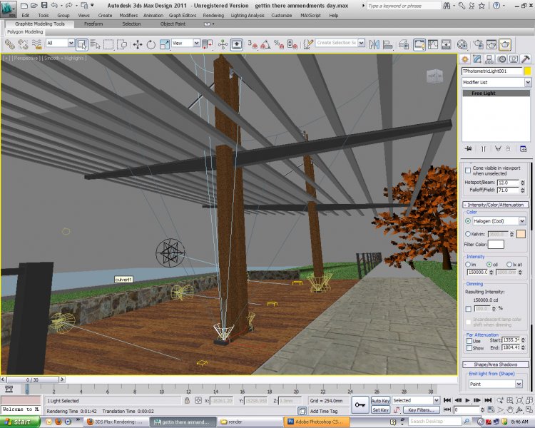

ok so I upped the intensity to 150,000. I did not really adjust my distribution, check out my screen cap.. anything you would change? Upping the intensity actually worked not to badly, the base doesn't seem to bright.
Looks pretty good.

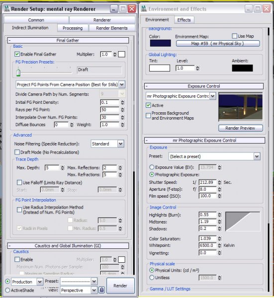

GI is turned off > it seems to mess with my lighting settings so I don't bother as I have a deadline for work I have not got the perks of playing around.
Image precision is low, and view set to HDTV (video) 1920x1080. with Force 2-Sided on, the rest is normal in the common tab.

You will get much better results if you try using the "High" FG Precision Preset. Also, experiment with adding Diffuse Bounces. Start with 1 bounce and see how it goes. Diffuse Bounces can really help spread the light around and brighten up your scene, but more bounces means longer render times, so try to keep that number low.
On the "Renderer" tab, set your "Samples Per Pixel" to Minimum = 4 and Maximum = 16. And set the Filter type to "Mitchell".
And in your Environment settings, unless you really know what you're doing with the shutter speed, aperture, etc., you should switch to the "Exposure Value (EV)" option, with a setting of 14.5, and choose the "Physically Based Lighting, Outdoor Daylight, Clear Sky" preset.
Those are the settings I typically start with, and then depending on speed and quality, I will start tweaking from there.
Oh, and you might want to add a little touch of orange tint to the Global Lighting in your Environment settings. This will help you achieve more of a sunset type of appearance.

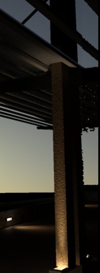

The render with your settings you suggested did finish as I left it over night, it took 2hours and 10mins, it looks good but for some reason when I print there is a slight film appearing over the image, its almost non existent but seems to be there, it might be a directional light i'm putting over the shelter to light it up. A bit unsure see if you can pick up what I'm talking about in this image otherwise its my printer. :x

I can't really see a film in the image. Maybe it's just your printer?
