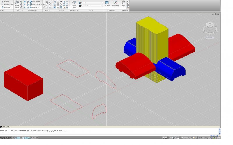

i am trying to make a mass of a car and can't get it to work. it seems that you could create slicing planes out of 2d objects and slice through a solid from 3 directions (top view, front view and side view) and have the car shape left over. See attached and let me know what I'm missing. Bear in mind that some of the shapes are splines, so I can't make closed polylines.

Hi Qball,
Try Intersect command in solid editing tab.
Bye
Pascal
