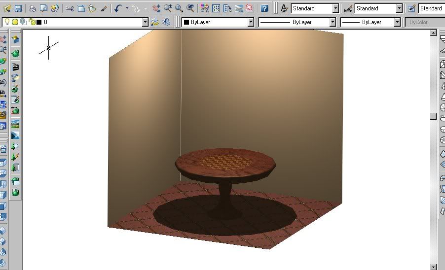

shift1313 Posted September 13, 2008 Posted September 13, 2008 thinking about this i made a table quickly in 05 and rendered it. Quote
shift1313 Posted September 13, 2008 Posted September 13, 2008 i was in a hurry when i posted that. i just thought it would show you what a quick render with the basic materials loaded into acad05 would give you. if you play around with settings and things in 07 you can get a much better likeness. I think the drawing took a few mins and a few mins worth of playing with settings and rendering. Quote
