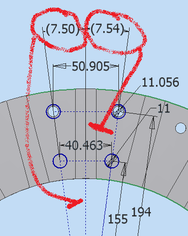

i am trying to constrain a small plate with two holes in it to a flange, both sets of holes have the same center to center distance, so i have no idea what's stopping it from working
i tried insert on both, or insert on one and center mate on the other, mate on both, or even mate and tangent, i was able to get it to work once (not sure which combination worked), but since then i had to change a dimension somewhere so now its not working again
here are the parts in question, where they go should be relatively obvious (if not check the center to center distance)
constraint problem.zip

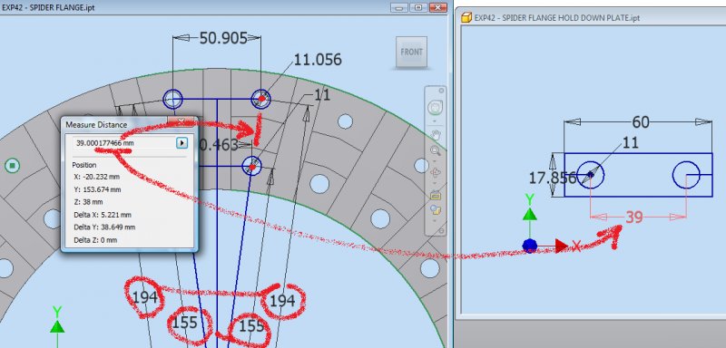

I would have done this part differently. Continue the angled line center to center of the holes and dimensioned the aligned distance 39mm. Your distance is not 39mm.
Also you have repeating dimensions - use symmetry or equal constraints to avoid this.
Missing a perpendicular constraint in Sketch 3.
Don't use trig when you can use geometry.
7.5 is not same angle for both sketches.
If you want different angles you can still use different angles, but dimension the angles and center to center distance - not calculated distance.

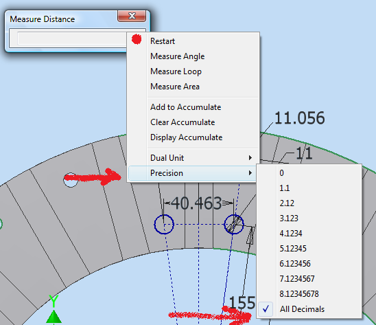

i thought that might be it, but why doesn't it show that when you use the measure tool? that's what its for isn't it? and yeah, i was a little sloppy, i made this a few month ago before i was very good at it

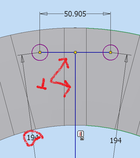

oh and my sketch 3 has the perpendicular constraint, not sure why yours doesn't
See attached.

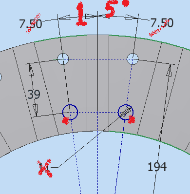

I would have used one sketch to locate all four holes to be patterned. (With one 15° to replace the 7.5 I show here using your example.) No circles for holes.
This is a pic of your Sketch3 with Show All Constraint - no perp constraint, in fact if you had perpendicular constraint it would not even allow you to place that redundant 194 dimension.

yeah, not sure why i wouldn't have used perpendicular, likely because i hadn't gotten a full handle on that kind of thing when i drew this the first time
