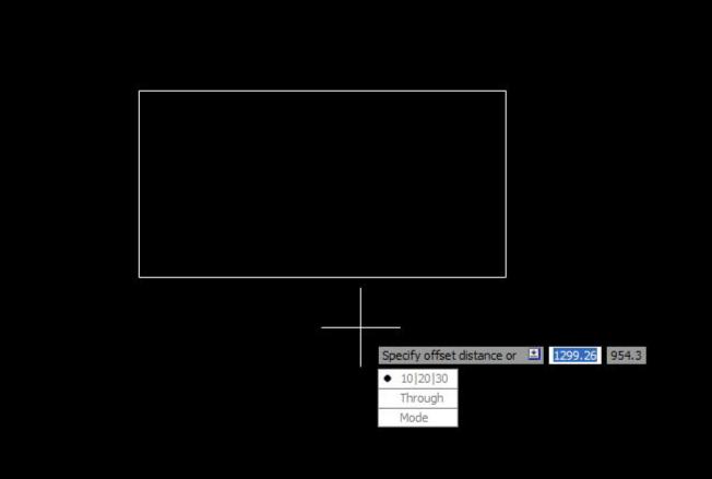

martyn60 Posted August 26, 2010 Posted August 26, 2010 When I am offsetting elements in a drawing sometimes i want them on a different layer. My training manual shows me how to do this but the layer option is not available. When starting the offset command, pressing the down arrow key does not give me the layer option. Can I add the layer option to this menu? (See attachment) Martyn Quote
ReMark Posted August 26, 2010 Posted August 26, 2010 I know the Layer option is available in generic AutoCAD as I can see it on the command line. I'm running AC 2010. Quote
martyn60 Posted August 26, 2010 Author Posted August 26, 2010 I'm sure you are correct about the layer option being available in generic AutoCAD. There must be a similar option in AutoCAD Mechanical. May be AM isn't quite as comprehensive, I'm not sure at the moment. Quote
ReMark Posted August 26, 2010 Posted August 26, 2010 I would expect the AutoCAD component of Mech to be just as robust as generic AutoCAD. To confirm open your Help file and look up the Offset command. Quote
martyn60 Posted August 26, 2010 Author Posted August 26, 2010 I would expect that too but there are differences. i.e there isn't the "Action Recorder" facility in AM. However, I have found the solution to the Offset issue. First you have to set your current layer to the one you want the offsets to adhere to. Then from the drop down menu (in the offset command) it is necessary to select "mode" then "current layer" from the next menu. From that point onwards any offsets occur on the current layer. Martyn:) Quote
