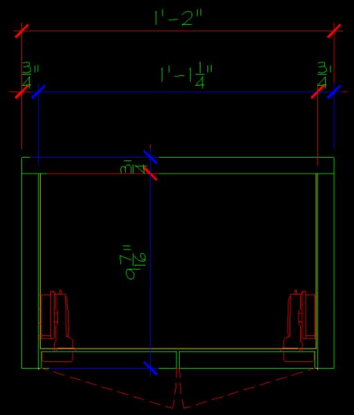

Is there any lisp routine to find overlapping dimension (like on picture below)
It's hard to see dim's like this. It happen very often when we use DIMCONTINUE.
And it cause big problem in manufacturing process.
Someone can help:(

I know overkill but this is not exactly what i want.
OV delete dims. We need to play with fuzz distance.
I'm not so good in lisp to fix OV to work for me

my all dims are with the same style.
what i want achive is too find these overlap dims (maybe flag them) and of course correct these mistakes.

You could check for intersections between the dimensions, however this method will only use the boundingbox of the dimensions and so will not be 100% accurate.
To demonstrate my point, try this code on two overlapping dimensions:

That one is pretty much bad drafting habits. Continuations should be just that. A continuation in the same direction of the previous dim. Not overlays. -David

Thanks Lee for the code.
Probably now this needs to be combined with checking of DXF code for dim's to see if the dimensions are continued, maybe one dim include another etc.
Is it possible to make reactor for DIMCONTINUE command?
After command we move cursor to the left or right side of dimension and new dimension flip to correct side.
