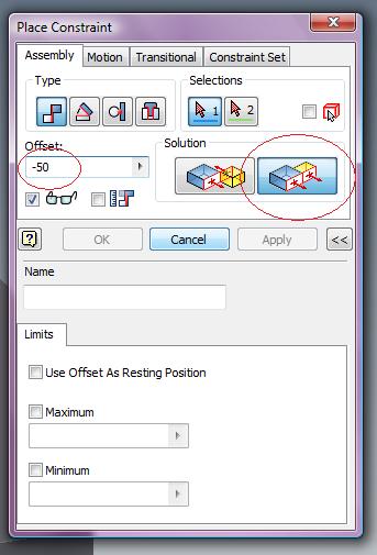

How are they constrained in the real world parts? Offset mate constraints might be one method. Mated threaded fasteners might be another. Can you attach your assembly here?
When you open the constrain panel. You will notice in the top right 2 different types of solutions as to how the mates are to be placed against each other.
The 1st is a "mate" which basically forces the to parts face to face.
The 2nd is a "Flush" mate where the two faces face in the same direction.
If you click on the "flush" mate select the to of the bracket (I'm assuming its flat) then select the top of the "pole" (also assuming this is flat) then enter a number into the "offset" box. (eg, 50mm or -50mm depending on which way you want it to offset) Click apply!
Hopefully this will give you a "little" start.
thanks guy, the offset mate constraint worked!
No problem, if you need anymore help just ask. And welcome to cadtutor.
