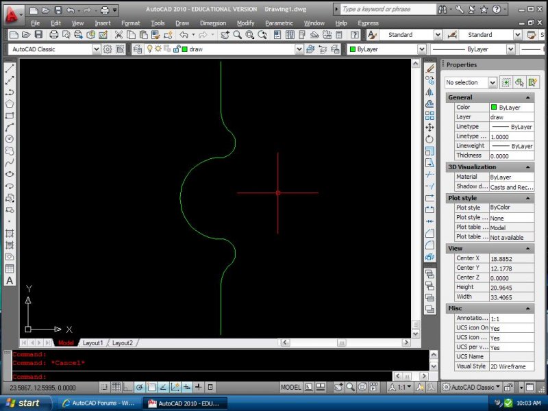

toberino Posted August 28, 2010 Posted August 28, 2010 Does anyone know of or can help me create a lisp that will copy or offset a block from a basepoint to a particular length following a polyline with arcs and lines? Quote

toberino Posted August 28, 2010 Author Posted August 28, 2010 Alright, I am going to describe what I mean with the help of some screenshots. This first shot is to show you the line I am dealing with. This second shot shows a total length of the line. I wil continue to edit this until I get what I need. Quote
Lee Mac Posted August 28, 2010 Posted August 28, 2010 Search for Alan's CopyAlongCurve.lsp It should do your bidding. Quote
toberino Posted August 28, 2010 Author Posted August 28, 2010 OK, I will go no further explaining my scenario. Alan's routine is exactly what I was looking for. Thank you Lee Mac. I am going to post the link to it so if anyone is searching for the same thing and come across this post they don't have to search for it. http://www.cadtutor.net/forum/showthread.php?46309-CopyAlongCurve.LSP-Divide-Measure-Dynamic&highlight=CopyAlongCurve.lsp Quote
