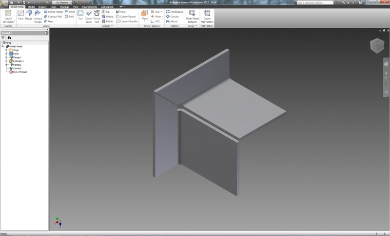

One problem that has bugged me for quite a while now is how do i go about making a sheetmetal part that has multiple pieces that require welding once cut and bent?
I know you can make the first part, then insert it into an assembly and then create a new part, but the 2 parts then dont interact with one another. I cant use such commands as corner seams and mitreing of flanges etc.. (to then create flat patterns)
This has become quite frustrating and time consuming having to manually edit each and every external mitre between parts often ending up with obscure results.
I have racked my brain and played with any option i can think of to create 2 flat patterns within a sheetmetal part to no avail.
Can someone point me in a new direction?
I have attached a real quick example of a typical sheetmetal part i deal with.
As you can see there is no possible way to create 2 flat patterns.
Any help on this work flow would be greatly appreciated.
Cheers Josh

The be honest i dont fully understand the derive command, i have played with it a few times but i really dont understand what i am actually doing. I have thought i have done it right but when i view the assembly that i just created there are no parts within??.
I have a done a quick sketch up of a typical sheetmetal part i deal with every day, this took me 5 mins using nothing but the sheetmetal tools. If i was to do it the otherway (as in create an assembly and draw all parts within then have to edit each part manually so they "fit together") it would easily take me half an hour and then i would still have atleast one problem/error.
The idea of the example is to create 2 flat patterns from the 2 seperate solid bodies, nearly all the sheetmetal parts i make need to be welded.
Any help/advice on this matter would be greatly appreciated..
On a side note, does solidworks allow multibody sheetmetal parts?
PS i tried to upload the IPT file to the forum but its to big. so i will attach a PDF file instead.
Cheers Josh

Please find attached my IPT file, no rush on replys i can see your a very busy man about the forums :)
Example1.zip
Here is my first attempt.
Pull down the EOF in each part (starting with Multipart Master - you will get an error, but ignore).
Make sure all files are in the same folder.
I simplified the technique of creating your part - it returns an error in the Master, because of course that cannot be unfolded.
The part is then derived into individual parts.
I left a bit of clearance for manufacturing tolerance and assembly (see Thicken Features in Base part).

But i do need a little help with the work flow.
As i understand it, you created the whole model first? then "cut" the indivual parts into seperate files using the derive command? then created a weldment at the end to tie up loose ends?
Thx again for your help.
Cheers Josh
Any changes made to the master file will be updated in the derived parts. So you can model as the finished design will look in the master and then devide it up as needed. You could add the weld beads in the weldment assembly if you need for 2D drawing documentation (or just add symbols rather than modeling the beads).
