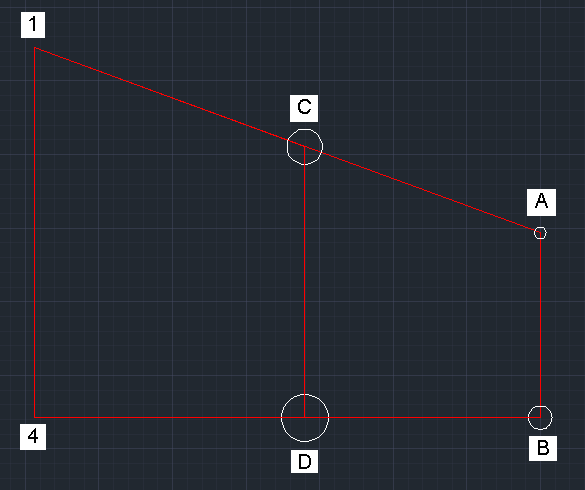

I'm trying to split a polygon into 3 separate pieces using the GetSplitCurves(Point3dCollection) method.

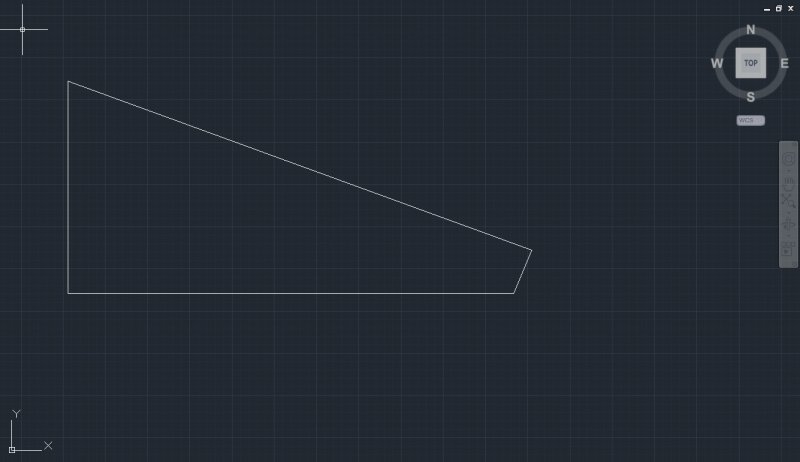

The original polygon looks like this. It is a Polyline object and is closed.

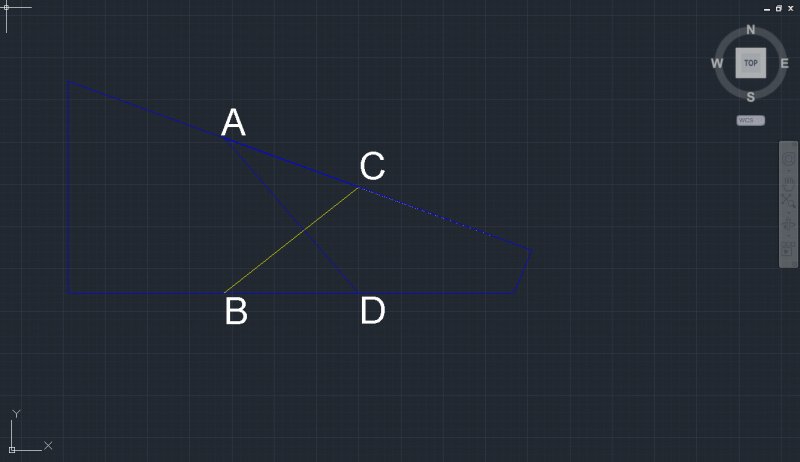

I pass in the Point3dCollection which consists of the points A, B, C and D, in that order. When I check the vertices of the returned entities, I get 2 polygons instead of 3, and the vertices are not in the right order:
May I know if it's possible to pass in the 4 coordianates so that when the polygon is split, we get 3 polygons - the center polygon would be A, B, C, D, the other two polygons will be the two sides?

Is it possible to isolate the splits? Only add points A & B to acPt3dCol, GetSplitCurves, Close each entity in acDboCol.
Then
Clear acPt3dCol and add C & D, GetSplitCurves on the curves in acDboCol, . . . .
The one issue is that C & D will only fall on one of the two closed polys from the first iteration. That may not be a problem unless speed optimization is a major concern.

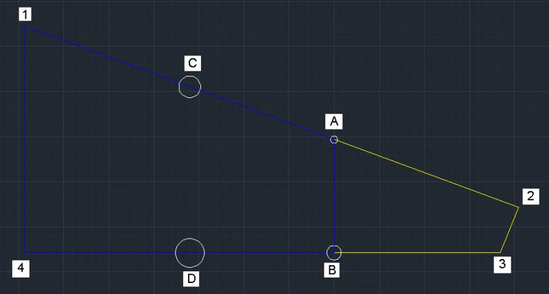

Yup, I tried that method as well, and getting strange result.
I just want to clarify that all these are done as background computation, i.e. the application is not actually drawing the entities, the Polyline instances are used purely to get the vertices of the split polygons.
I call the GetSplitCurves, passing in 3dPointCollection (consisting of A, B). In the loop, I do the casting of Entity to Polyline and set the Closed to true.
In the first iteration of main loop, I call another GetSplitCurves on Polyline (A, 2, 3, B), passing in 3dPointCollection (consisting of C, D).
In my case, it throws an Autodesk.AutoCAD.Runtime.Exception with the ErrorStatus == InvalidInput, so I ignore it and just store the result anyway, as it seems to be a case where I try to split the polyline with another polyline that is outside.
Then, in the second iteration, calling the GetSplitCurves method on Polyline ( A, B, 4, 1) with 3dPointCollection (consisting of C, D) returns 1 Entity with 8 vertices. This Entity is a Polyline with the vertex order (D, 4, 1, A, B, 4, 1, C).

I am guessing I need to somehow reorder the first segment of the split polygon so that the starting point of the second splitting polyline lies on that segment. I might be wrong, but it looks to me as though the GetSplitCurves() algorithm is going by a clockwise order and then split up the polygon.
Still working on the reordering algo. Ugly code, will have to refactor later once I get it working. :geek:
I thought of using the Geometry namespace, but couldn't figure out how to get the split polygons. It might result in cleaner code.
