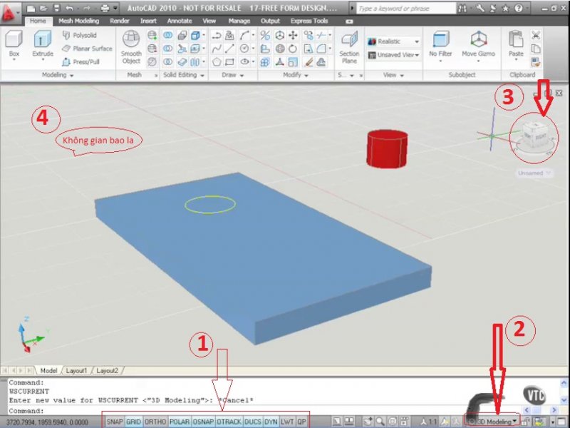

Hi all,
I have a question after seeing the VTC's tutorial.
In Autocad 2010, with 3D Modeling (2), How to do to make the interface like (1), (3) and (4)?
Thanks in advance,
Khuduba.
Edited by khuduba
4. Grid on
3. Shademode on
1. right click to change the images to words (I can't remember exact terms).
1. That area you're pointing to is your System Tray and the options you see are called the Tray Settings.
2. That's referred to as the 3D Modeling workspace. Click on the Gear icon to see a list of available workspaces.
3. The object shown is the View Cube. Access it via the View tab > Views panel > View cube or from the command line with the navvcube command.
4. The F7 key enables/disables display of the Grid.

Also, you can open up the acad3d template.
A simple option that only requires the user to select File > New and from the list of available templates click on acad3d.dwt and away you go.
