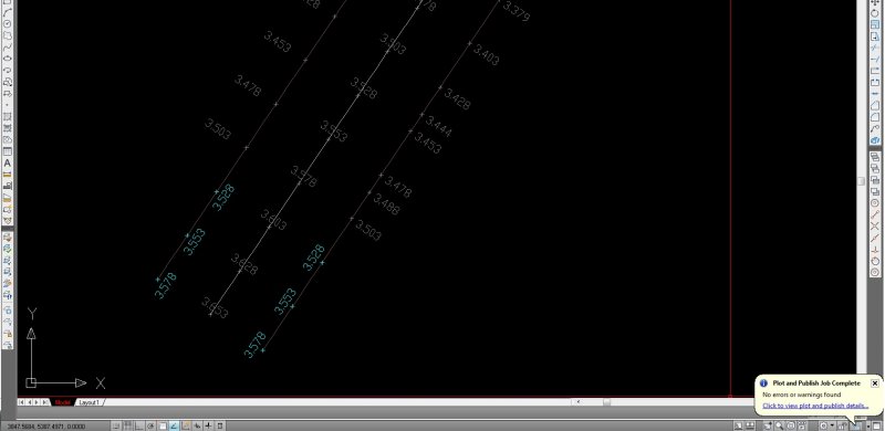

CSTAM Posted September 6, 2010 Posted September 6, 2010 Does anyone know of a Lisp or function that can rotate text without a basepoint? I have text perpendicular to a designed road and I want to add (or minus) 90 degrees to make it parallel. I need something that can basically add 90 to the all selected texts "rotation" property. My problem in visual format below. The blue is desired. Quote

CSTAM Posted September 6, 2010 Author Posted September 6, 2010 No, when i select all the text the value in the properties palette turn to "varies". Is there a way to put "varies"-90 degrees? Quote

CSTAM Posted September 6, 2010 Author Posted September 6, 2010 @ migs- I tried your suggestion but it orientates all selected text in the same direction. This doesnt appear to be any different than typing a value in the properties palette, unless i'm doing something wrong :S @ ReMark- The text is not centrered on the point it represents but if you could find this LISP I could still give it a go. Quote

CSTAM Posted September 6, 2010 Author Posted September 6, 2010 THAT'S BRILLIANT!! Thanks for your Help! The TXALIGN is exactly what I want, even better actually! Quote
