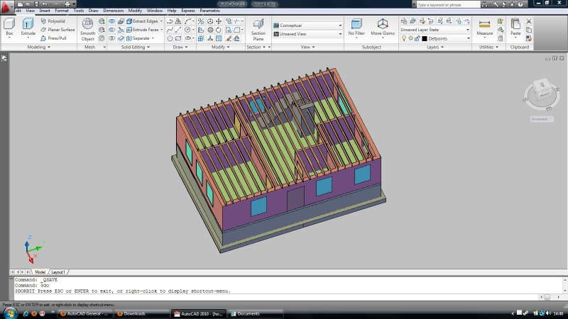

woodsy Posted September 10, 2010 Posted September 10, 2010 (edited) right basically i finished college last year and due to the way everything is nowadays there are next to no jobs and to keep myself busy i have been giving myself little projects to keep myself occupied, anyway i decided to draft a 3d model of a 2 storey house in cad but im having a little trouble with the 1st floor. i appreciate it if someone could help with the next few steps just to get me on my way woodsyhouse.zip edit: added zipped .dwg file Edited September 10, 2010 by woodsy Quote

woodsy Posted September 10, 2010 Author Posted September 10, 2010 not really too sure what i should be doing next, should i do the layout of the 1st floor? how would i go about fixing the joists so it would create an opening for the stairs just anything that you would do next will be helpfull as iv been at this for a oo few hours and my brain is getting tired ha Quote
ReMark Posted September 10, 2010 Posted September 10, 2010 You did not create the 3D structure from a 2D floor plan? What do you have in mind for the second floor or haven't you worked up a 2D floor plan for that either? As far as creating an opening in your joists for the stairs you could SLICE the appropriate joists. You'll have to properly finish the framing around the opening too. It might help us if you posted the dwg file (may have to be zipped) so anyone trying to assist you can view the drawing better than just looking at the above image. Quote
profcad Posted September 10, 2010 Posted September 10, 2010 You may want to review how wooden floors are constructed. The floor joist should on a sill and enclosed in a band similar to the graphic below. I would construct the floor the sill, then the band and place the joist next. Then cut the opening. Be sure to double up the joist around the opening. Then add the subfloor and you are ready for the walls. There is an online book called "Details for Conventional Wood Frame construction" located at http://www.awc.org/pdf/wcd1-300.pdf Quote

ReMark Posted September 10, 2010 Posted September 10, 2010 I guess I'm still stuck in the past. I would have worked everything out in a 2D floor plan (people do change their minds!) before moving to 3D. Thanks for the file. I think profcad was using his super powers because I missed that small detail he caught. Time for some new glasses! Quote
Bill Tillman Posted September 11, 2010 Posted September 11, 2010 Actually, Procad did catch something but I don't see too many houses being built this way. It's too time consuming and costs too much. The way they slap together houses these days you're lucky if they even use a band joist let alone a separate sill. And most houses in the southern US are slab on grade so there is no crawl space as shown. But if you want to frame out a stairwell opening you need to study the SLICE command and get used to using SOLIDEDIT. Also I would encourage you to study how to move and orient your UCS to where you will need it. SLICE only works when you slice in the appropriate plane. I was very confused when I first started 3D but once I got the UCS mastered it became a very easy task. And just like out in the field I will often draw myself a 2x4 or 2x10 at full length, place it where I want it such as a floor joist or roof rafter and then SLICE (saw) it off where needed. Quote
