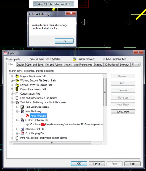

every time I try to enter / alter text, autocad informs me that it can't find a dictionary for spell checking purposes. I can live with that, but the constant pop-up is getting old.
I tried to reset my Main Dictionary... but it seems to be gone. Is a fresh re-install in order?
See pic attached

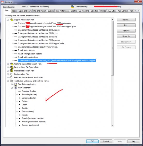

I ended up doing a search for my damn missing files (*.dct), and spotted the russian one in the file list (rus.dct). Turns out these were another copy of the dictionaries from a 30day trial of AutoCAD 2011. So, problem solved, but I totally cheated.

Dictionaries are located at C:\Program Files\Autodesk\AutoCAD Architecture 2011\Support.
Add this file to "Options, Files, Support File Search Path". Then go down to "Text Editor, Dictionary and Font File Location". Select "Main Dictionary", choose your language (American English in my case) then click "Set Current".
