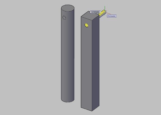

Frana Posted September 15, 2010 Posted September 15, 2010 Simple question, I hope... Moderately new to the 3D modeling. Just learning on the fly. Came across an issue I can't find the solution to. I have created an 1 1/4" cylinder, 10" long. I would like to basically "drill" a hole through the side of this, for like a locking pin. I can't seem to press/pull the regened circle through, because it's not recognized against the curved side of the cylinder? I can easily pull a hole through the top of the cylinder, just not the way I need to. Any help is appreciated, thanks! Quote

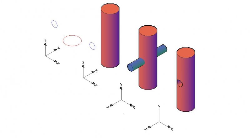

ReMark Posted September 16, 2010 Posted September 16, 2010 Press/Pull will work. As previously mentioned the key to its success will be the orientation of your UCS as demonstrated below. Quote
Frana Posted September 16, 2010 Author Posted September 16, 2010 Thanks for all the help. I only work in respected top,btm,l & r... views for coordination to my drawings. As for any sort of modeling adjustments, I found that using the correct USC isometric views are far more beneficial. So, this didn't seem to be my issue? Using a 1 1/4" block with the same methods I've been using, allows me to press/pull this hole through. But there is something about the cylinder? Probably the fact the there is, in some scientific, mathematical, most insanely factual explanation... literally only one point that physically touches the two opposite planes? Funny is all. Good point of my rambling is that I didn't realize that you could add/subtract 3D objects as JD suggested. So, thanks! This method worked out great! This is a beneficial approach for future drawings. I truly do appreciate all the help, and in such a timely matter. Quote

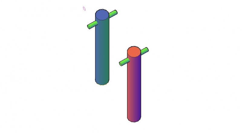

ReMark Posted September 16, 2010 Posted September 16, 2010 This is it. The blue cylinder has had the circle for the hole extruded through it as per JDM instructions prior to subtraction. The red cylinder has had the hole press/pulled through it just as I said it could. Note the magenta circle next to the blue cylinder. That's the extra circle you had created. I moved it out of the way. Quote
Frana Posted September 16, 2010 Author Posted September 16, 2010 Yeah I forgot that I had the DELOBJ set to 0. So, why is I still can't press/pull through? If the top of the cylinder is drawn from the top view. And the smaller hole is placed on the front, what view are you using right to press/pull through? Also, I see that your circle is not against the face of the cylinder, is this why I can't get it to work? I moved the hole away from the cylinder, much like your drawing, and I still can't get the recognition of a regioned area to press/pull... Quote
ReMark Posted September 16, 2010 Posted September 16, 2010 Your circle was a region. I blew that away and substituted a plain circle. I relocated my UCS (which I almost always have turned on) to the center of my new hole and then turned my view using 3DO. Press/pulled my circle through the cylinder and that was it. I assure you I absolutely used the Press/Pull command. No magic, real or imaginary, was used to create the image I posted. Quote
hoss Posted September 16, 2010 Posted September 16, 2010 Ucsicon On ucs origin centre of circle ( small circle) presspull Quote
