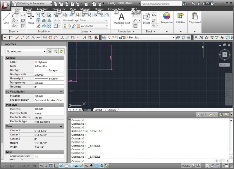

Perhaps I should explain clearer... lets view some of my layers. I want to set and create a "text style" for layer "A-Anno-Note" and "A-Anno-Dims". Ok, well I have a text style setup, but that applies to all layers and in order to change the text style I need to select the object and select a new text style, then the layer (if any) etc... etc... I guess, I'm looking to eliminate a lot of work. Create a Layer, set it's properties, and also create a style for text (font, width/height, etc...) for that layer alone and lock it to that layer. If text were added to any other layer I would assume the text entered will default to that I set current within the text manager.

I already have a template created... I would like to know if and how to create specific text styles to each and every (IF needed, for now just one) layer. I know how to create text styles in the text manager, but that is for the entire drawing template, and if you want to change text you need to select the object, highlight the text you created... apply it to that layer... select your text style and change text properties if needed. I'm looking to bypass ALL of that, create a text style for that layer once and only once. Am I making any sense? :)

excuse my ignorance... still learning. I guess I assumed the toolbar, it let me drag it there, but nothing happened. I'm not sure what you're referring to as the "tool pallet"
OK, hit the Ctrl+3 at the same time. To see all the palettes available, one method is to first set MENUBAR to 1, now go to Tools, Palettes and notice all the palettes awaiting you, oh joy, more to learn. :)
