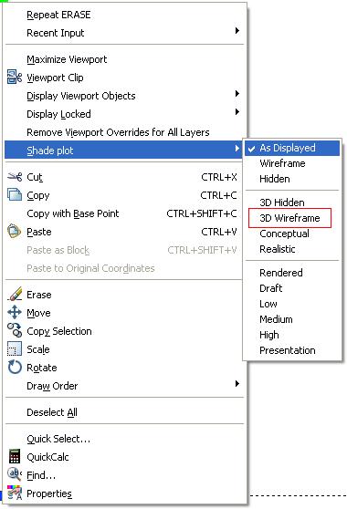

PaulSimms Posted September 16, 2010 Posted September 16, 2010 Hi, I've been struggling to get a decent wireline output as an image or DWG from my 3d model without using "printscreen". Any ideas welcome, thanks, Paul:) Quote
ReMark Posted September 16, 2010 Posted September 16, 2010 What's wrong with the output you are getting? Quote
PaulSimms Posted September 16, 2010 Author Posted September 16, 2010 Hi ReMark, I want to use the lines as sharp forground material for a stylised wash - like a sketch, Quote
hoss Posted September 16, 2010 Posted September 16, 2010 Right click on viewport, Shade plot, then select 3D Wireframe Quote
PaulSimms Posted September 17, 2010 Author Posted September 17, 2010 Hi Hoss, that's the way I've been doing it to date but half of the lines are missing:( Quote
ReMark Posted September 17, 2010 Posted September 17, 2010 What plotter or printer are you using? Maybe it's a driver issue (got corrupted)? Quote
PaulSimms Posted September 17, 2010 Author Posted September 17, 2010 :DI've just discovered how to do it! Set up the camera view to fill the screen (right click, set camera view) then type "flatshot" but send the result to a file not insert-as-block, and hey presto you get a 2D perpective which can be tidied up:Denjoy.... Quote
