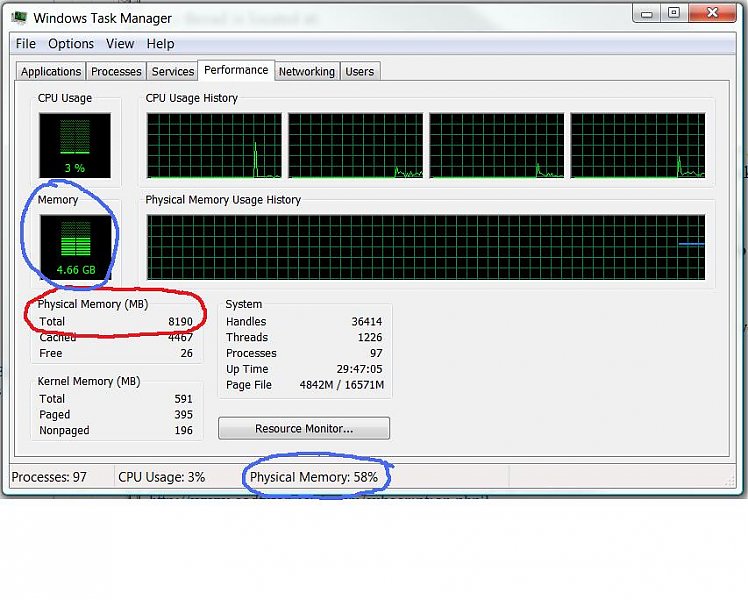

dumfatnhappy Posted September 12, 2008 Posted September 12, 2008 Check your memory (RAM). I was very unstable untill I doubled it to 8G. as I said in another thread, right click on the task bar, open task manager and check your physical memory against your RAM. You may be on the edge like I was.... Quote
dumfatnhappy Posted September 12, 2008 Posted September 12, 2008 the red is what I have on board the blue is what I'm using.... I originally had 4g installed..... now imagine the stability with that, all KINDS of crap was happening with no explanation.... Quote
neekcotrack Posted September 15, 2008 Author Posted September 15, 2008 the red is what I have on board the blue is what I'm using.... I originally had 4g installed..... now imagine the stability with that, all KINDS of crap was happening with no explanation.... My memory looks fine to me. How are you running 2009 MEP with so high of a memory usage? I usually run two at a time and mine still never gets about 50% of my RAM. Quote
