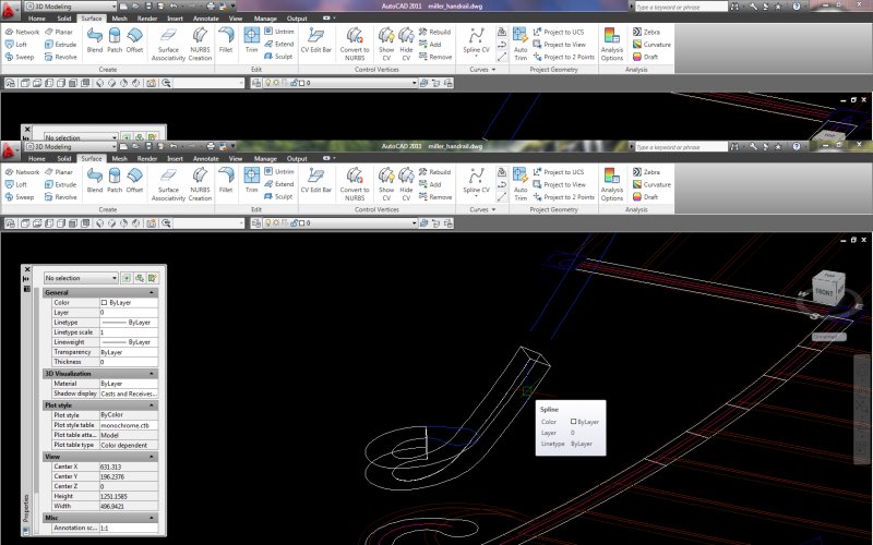

Have a look at the file i have attached.
Can any body tell me why it wont let me loft the 2 rectangles using 1 of the paths?
i need to extrude along that path to produce the right shape for machining.
Many thanks in advance
Damian

AutoCAD’s lofting functionality is somewhat temperamental.
I recommend simplifying the lofting guides, create perpendicular lines, LOFT, then THICKEN.
ViaThicken.dwg
Thanks Seant.
The only problem i have is that the sides of the finished shape has got to remain vertical. Basicly you shoud be able to fit a perfect rectangle all the way along the extruded shape:wacko:

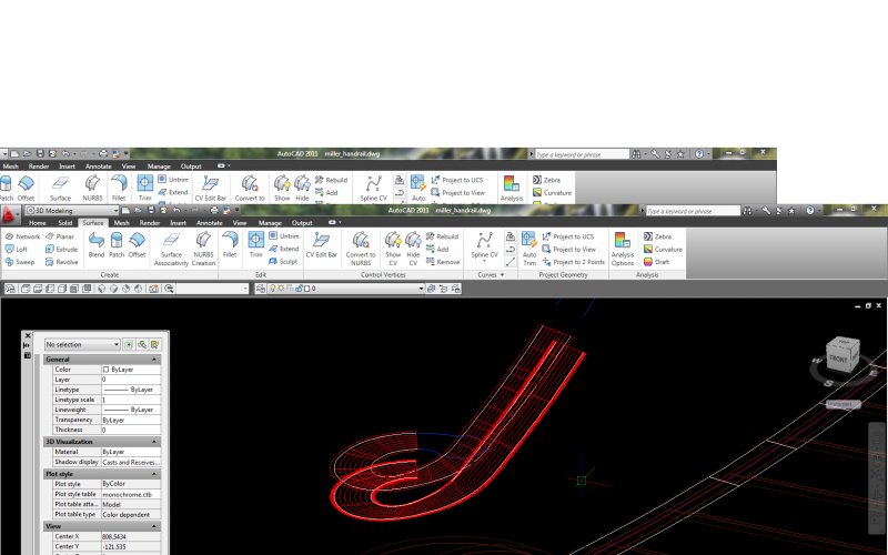

Ok I got it in the end..
I used the method SEANT used by drawing perpendicular lines and then Lofting them to form a surface.
I then extended the sides 10mm and then Unioned them togeather and offset it down by 78mm.
Finaly i projected the lines fron the 2D plan to both surfaces and the deleted the surfaces to leave the curves.
You can surface the lines to make it solid but i only need curves to inport to AlphaCam to tool path.
Thanks guys
Hopflly this method will help you in some way in the future :D:D:D
