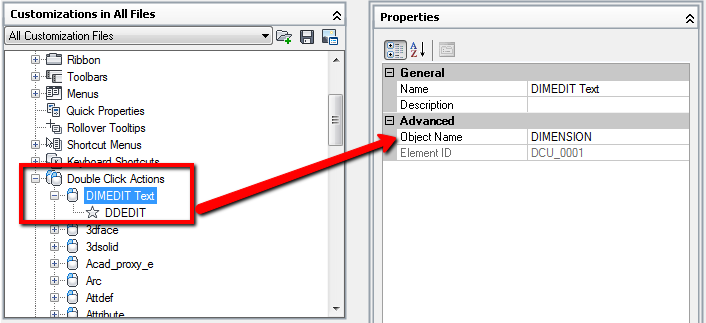

You can add one more doubleclick action. Give it a name, and fill DIMENSION in object name. This action will respond if you double click a dimension.
You don't need to add a macro for DDEDIT. The command name is Text, Edit...
Sorry for the name in attachment, I find the command after I uploaded the image.

Edwin - hey that works sweet!:D
Beats me why Autocad don't already have double clicking on dimensions as a default.
Many thanks for your effort
cheers S.F.
It has actually. When you double click a dimension, it will open the properties palette.
Yes but that's not the same as the Mtext Editor. You try editing dimension text in the properties palette. - difficult!
