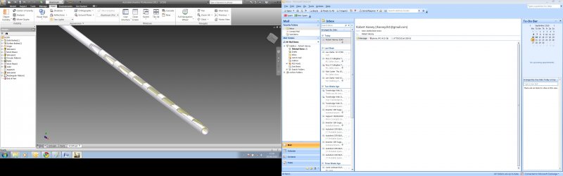

rdharvey Posted September 20, 2010 Posted September 20, 2010 (edited) I have a shaft with 8 slots in where the last slot is at 45 from the original. so the cuts kind of wrap round the cylinder. Is there any way to do this rather than using numerous work planes at different angles with the copy and pasted sketch extruded. I was thinking pattern type function that can wrap round a bit like a coil function... help anyone? On previous cad software I have used it is possible to do this as a pattern. hmmm :/ Edited September 20, 2010 by rdharvey add in a image of product Quote

JD Mather Posted September 20, 2010 Posted September 20, 2010 Curve driven pattern. (Misnamed "Rectangular Pattern in Inventor) http://home.pct.edu/~jmather/skillsusa%20university.pdf Quote
rdharvey Posted September 20, 2010 Author Posted September 20, 2010 got the coiled helix working, how do i get the cut to follow the profile of the tube? does the sketch have to be projected to the surface? Quote
JD Mather Posted September 20, 2010 Posted September 20, 2010 Doesn't look right. Attach the part here (roll up EOP and zip before attaching). Quote
shift1313 Posted September 20, 2010 Posted September 20, 2010 This isnt the most elegant solution but i think its what you are looking for. You want to change is the Direction1 and Direction2 orientation(dont remember if 2011 uses the same terminology). Basically you want it to "adjust" and not be identical. For direction2 you want it to follow Direction1(your curve). Hopefully this older model will open and be easy to follow. CurveSlot.zip Quote
rdharvey Posted September 20, 2010 Author Posted September 20, 2010 Swift, thanks exactly right i forgot to select direction one in the second direction. still grasping inventor after using proe and sw for 3 years! Thanks for the help as always Quote
