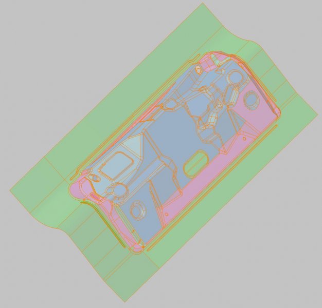

jossdude Posted September 22, 2010 Posted September 22, 2010 Hello, been reading around on the forum for a while but this is first post. I am currently having a bit of trouble on Inventor (I usually use Solidworks but my new job does not have the programme) I have been sent an Iges file that I want as a solid body, when the file is opened it is going me a combined feature that looks a lot like a surface but doesnt want to act like one. I have managed to work out how to split the combined feature into the separate surfaces. This is where the problem is, there are 977 surfaces that don't all seem to want to stitch together perfectly, when all are selected. Next to some of the surfaces in the browser there are green ticks, and next to others there are information "i" 's. I am assuming the ones without ticks need to be repaired, I have gone through and done this to the majority but as soon as I start to stitch the surfaces together the computer seems to be getting less happy and start to often freeze. After I had one surface I wanted to use the split feature over a solid body to give a solid with the profile of the iges file sent to me. Is there a general quicker way to achieve what I need to do. Thankyou in advance, Joss Quote

jossdude Posted September 22, 2010 Author Posted September 22, 2010 Im not allow to attach the file I am afraid but here is a screen shot of the part that I am sure will only make the problem easier to see. I think I might have got close to solving the problem now, I found a few rouge faces floating around that have deleted. Also don't think it helps not having the most powerful of computers helps either. Cheers for the reply Quote

jossdude Posted September 22, 2010 Author Posted September 22, 2010 That is definatly something I will use in the future but isnt an option for this application I am afriad. I have been sent the iges file and it is several years old and the original company no longer exists so I just need to work with what I have. Have manged to get it to work by stitching the surfaces, but everytime I come to stitch the last two the program stop responding and I need to CRTL+ALT+DEL to get any life back into anything. Any ideas? Quote
shift1313 Posted September 22, 2010 Posted September 22, 2010 Are the last two surfaces large or are they small patches? If they are small patches, can you manually recreate them maybe? Quote
jossdude Posted September 22, 2010 Author Posted September 22, 2010 One of them was the majority of the piece and the other had about 8 surfaces in it. Have ended up managing to stitch them by deleating a face on the final stitched faces. Then stitched the semi complete and large stitched together to leave a hole. Then patched up the hole to get a full surface. (well fingers crossed, waiting for the computer to think about doing it now) Thanks everyone Quote
