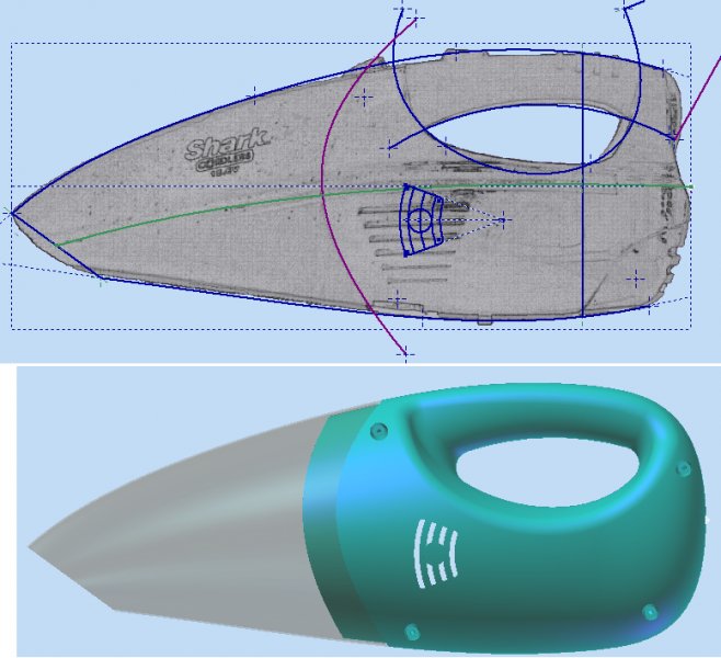

JD Mather Posted September 22, 2010 Posted September 22, 2010 Should be trivial. Attach a scanned image here if you have trouble. I always put on one sketch and fully constrain. Then do my other sketches. Here is a 3D example. Quote

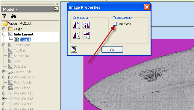

JD Mather Posted September 22, 2010 Posted September 22, 2010 Notice that I turned off the background of the image. Quote

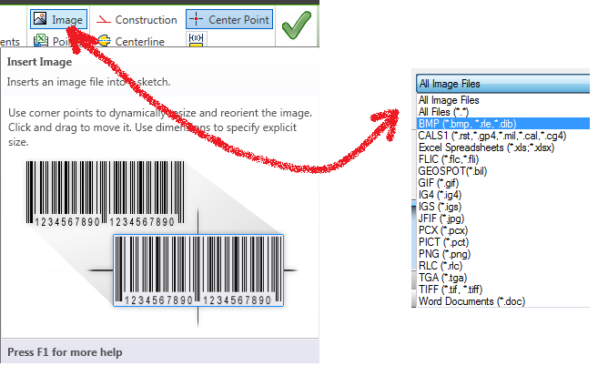

Hopinc Posted September 22, 2010 Author Posted September 22, 2010 (edited) Thanks but I still don't know what the preferred scanner file type is, it could be TIFF, JPG, PDF, BMP - which is best to get the most accurate transfer, and how accurate can I reaslistically expect it to be? I ask this because I know for example that when a Zerox print (OK so it's a different system) is made the image is actually scaled up by 1%. Although I have never understood why this is so. Could you please explain how you got that image on your sketcher screen? Thanks. Dave Edited September 22, 2010 by Hopinc Quote
JD Mather Posted September 22, 2010 Posted September 22, 2010 I've got to get back to work, but I'll come back and explain a bit more. Quote
Hopinc Posted September 22, 2010 Author Posted September 22, 2010 (edited) Ah! - now I see. I have never explored that icon before - I can't think why not. Thanks J.D. everything falls into place now. Regards. Dave Edited September 28, 2010 by Hopinc Quote
JD Mather Posted September 22, 2010 Posted September 22, 2010 Experiment with the different image types. jpg does not tend to work well. For some reason Word doc inserted works great, I saw the explanation somewhere that led me to realize why *.doc works well (and why I don't really need to use *.doc) but unfortunately I was too busy and now don't remember the best way. In any case an image generally needs to be scaled after import by adding a dimension and unless the object was thin and flat there is always going to be parallax error. But designers tend to use nice even numbers - so even if the image isn't perfect you can create sketch close to image and then dimension. Based on the dimension you can figure out the design intent and round the dimension to standard sizes/tools. Quote
