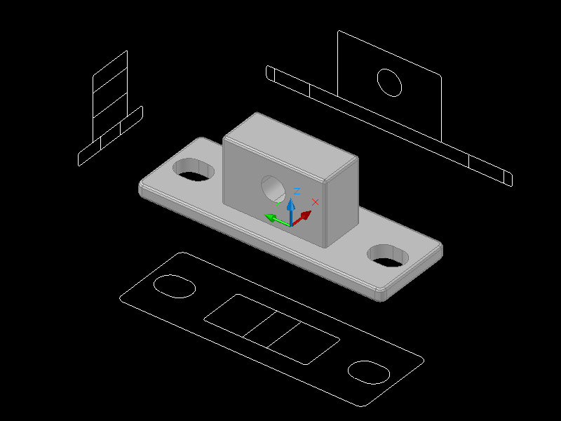

You can create your views directly from the model in AutoCAD, (if that is what your referring), however, I find it easier to use the 'flatshot' command to create the views I need since they are easier to dimension. I have all three views in model space here but you should put them on different layers for more control.
If your model is in Inventor it's even easier as it pretty much does if for you. I don't use .idw anymore and use inventor .dwg's exclusively since they can be opened and plotted directly from AutoCAD.
KC

Since you are doing this in AutoCAD you should be aware there are two other ways of producing 2D views from 3D objects. They are Solprof and the combination commands of Solview/Soldraw. Each has its advantages and disadvantages.
