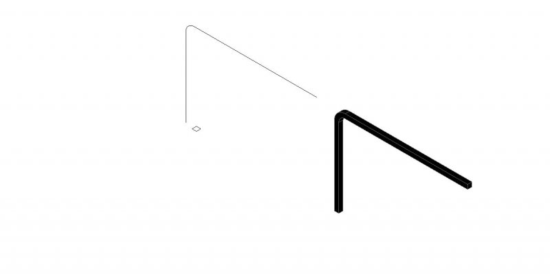

Can some one please help. How can I make a bar of metal 50mmx50mm by 2.5m bend over 100mm, 1/2 way up the bar. I'm doing this in 3d. Thanks. :oops:
Something like this? I did not use your dimensions.
Done using the SWEEP command. The "path" (single line) was drawn with the UCS reoriented.
Users of older versions of AutoCAD (ex. - 2000) do not have the SWEEP command. Use the EXTRUDE command instead. Placement of the object to be swept is critical. Your results may vary.
