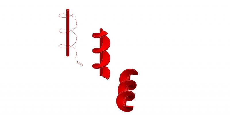

I have been requested to provide an Isometric/3-D?, drawing of a screw conveyor screw and am seek your assistance in providing this drawing, as I am am not sure how to do this myself?:unsure:

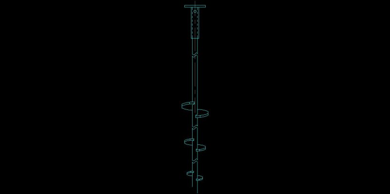

You're looking for something similar to this?
Perhaps this will be more to your liking.
I created my center post using a circle and the Press/Pull command.
Next, I created a helix to wrap the post.
Then I created my blade profile using the Rectangle command.
Finally, I used the Sweep command with the Base Point option. My base point was the lower right-hand corner of the rectangle.
Hope this helps you Wilbri. Nice to see you back.
Many thanks for your reply REMARK
It's good to be back.
As usual you have provided just what I am looking for.:)
