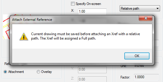

Cad64 Posted September 25, 2010 Posted September 25, 2010 Have you saved your drawing yet? Relative paths cannot be assigned until you save your drawing. Quote
MarcoW Posted September 27, 2010 Author Posted September 27, 2010 Hello CAD64, Thank you for taking time to help me out. The drawing itself is already saved, I have been working on it some time. So that might not be the problem... I got a different message / alert (compared to your example) that said "Relative path cannot be assigned". Now I wanted you to show the message, but now it does not pop up anymore.. What did I do? But I am shure it is the same way! When I got the message, I attached it with a full path, after that I deleted the path and put in the dot ("./images/image.jpg") and it worked. I figure that if "it works manually, but not automatically, and both ways should do the same" there might have been a temporary bug or something in the AutoCAD session that was currently opened. Anyway, for now there seem to be no more problems, but if it appears to be back, then I will be back here Thanks again, Regards, MarcoW. Quote
