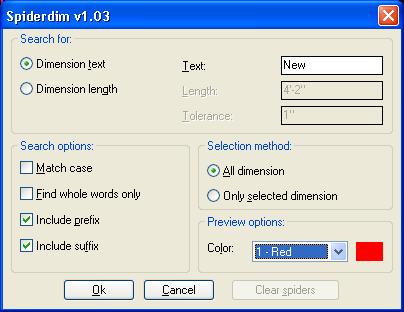

I just want to share small lisp routine. Maybe someone find it usefull.
Any comments and suggestions are welcome.

thank you for your share.from the show,it seems it is used find matched texts in dimension.??

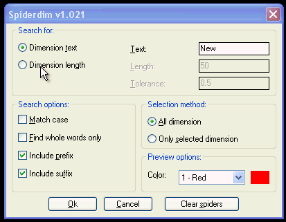

yes, lisp go thru dims and mark them with lines (spider). it is much better then selection set from autocad find command and not disappear after screen regeneration.

Personally i do not prefer any modification to drawing (like making additional layers, changing object properties until it is really necessary).
I agree that put-color will be faster but i also want play with grread. I'm still rookie with this.

What if the text is within the Prefix/Suffix (set in style) instead of TextOverride?
aaa good catch Alan. I don't even think about this (my brain is to small).
i see what i can do with this.
