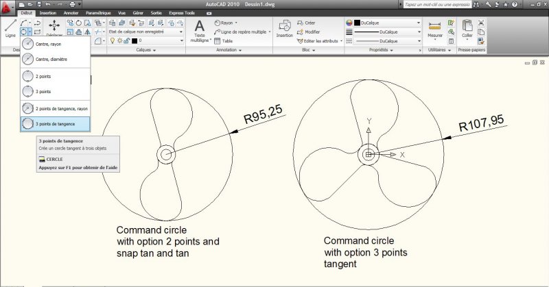

Andre Posted September 26, 2010 Author Posted September 26, 2010 hallelujah i did it!! notice the ri r2 r3 r4 leaders attached to the scaled and arrayed propellors i think it wants to know what the new radii of the scaled down propellors Quote
rvpas Posted September 26, 2010 Posted September 26, 2010 I agree with you, it's radius of each propellors. I think You have to draw a tangent circle with the edges of blades. see my example sorry I got only french version good luck Pascal Quote
Andre Posted September 26, 2010 Author Posted September 26, 2010 Ok pascal i got values for r1 r2 r3 r4 i will double check with my tutor that im on the right track, thanks very much for all your help, merci beaucoup, abientot (probably Quote
