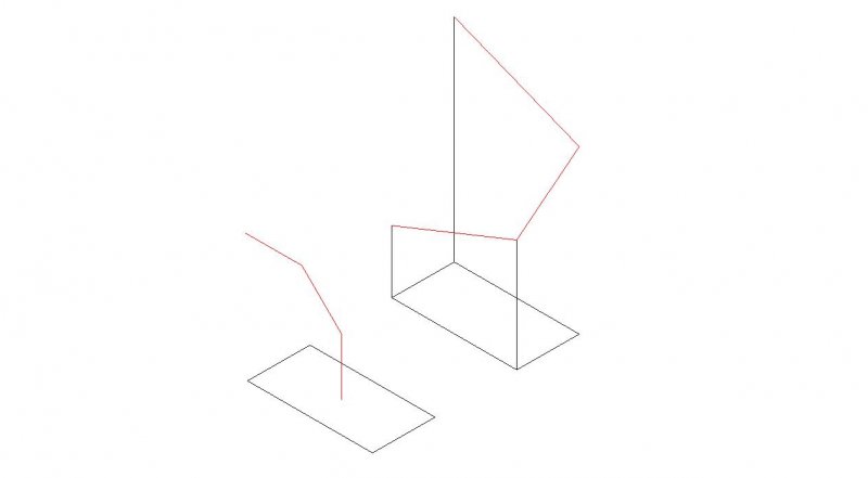

Two examples of 3D polylines (both shown in red). Each one is continuous.
Not sure why the fourth vertical line is missing in the back image but there should have been one visible. Sorry about that.
ok the rectangle with the line coming up, could u explain the commands for the line that comes up and out eg @45
Commands used were Rectangle, 3Dpoly, and M2P (for midpoint between two points). M2P must be used within another command like drawing a line or moving an object when AutoCAD prompts you for a basepoint. The line segments themselves were done using direct distance entry.
