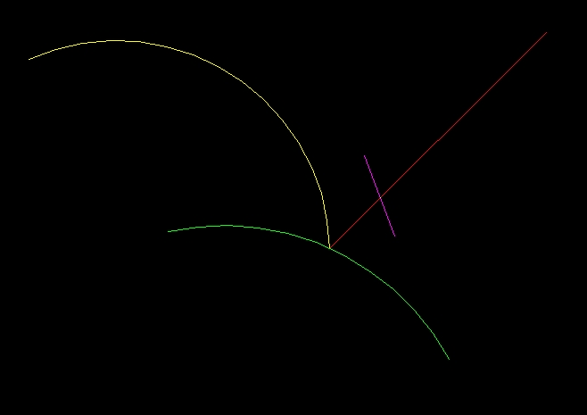

Alan,
I would think that would have a chance of return erroneous results if the user adds transparent osnaps during the selection:
Select line red line using _end near the magenta line but not on the arc. It says it has a radius. -David
test.dwg
Alan,
Yeah, it does have that limitation.
