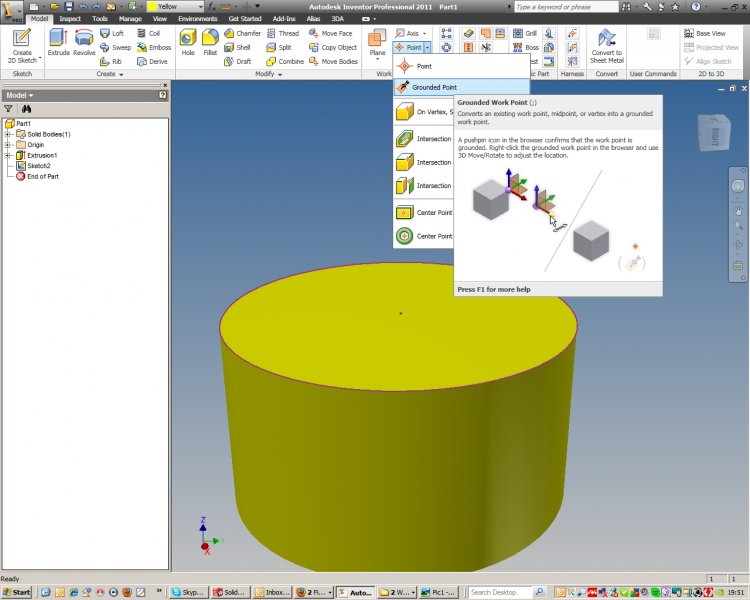

There is yet another way to create a dome, and although it may not be particularly applicable in this case, I thought I would illustrate the technique - and that is loft. First create a sketch on you work piece. Click "OK." Go to the "Work Features" menu on the top ribbon bar and select "Grounded Point" (Pic1).

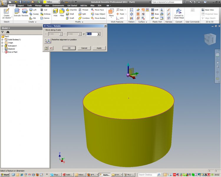

Select the centre point of the workpiece for your Grounded Point and a trident will appear (Pic2). Click "OK."

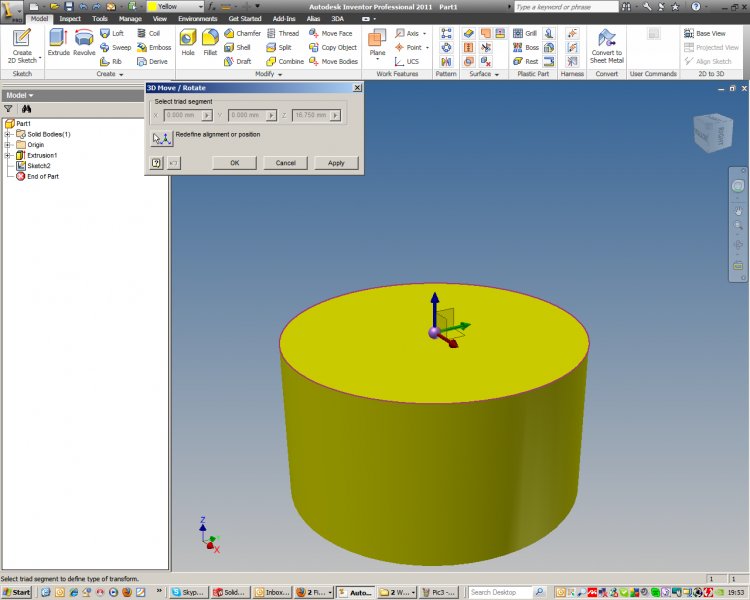

Now move over to the history tree and right click on the Grounded Point. A new pop down menu will appear - select "3D Move/Rotate." You can now select one of the arrows and drag the trident in the required direction (Pic3). Click "OK." This will leave a clearly discernable yellow diamond at the new position of the Grounded Point.

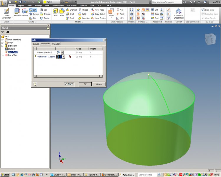

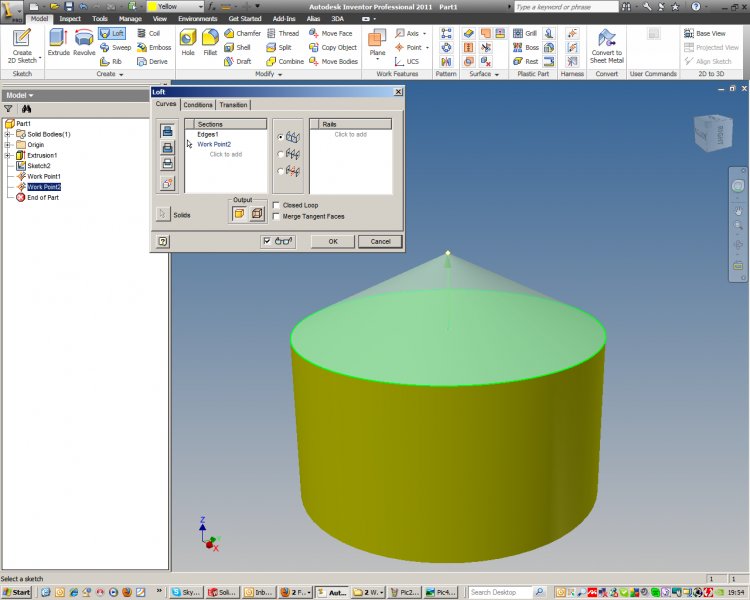

Select Loft - choose the edge of the sketch and the Grounded point (pic4). At this point you have controls over tangency under the "conditions" part of the menu (Pic4). Picture 5 has tangency switched on. Click done.
Of course you can return at any time to the Grounded Point and re-position it and change tangency as desired.

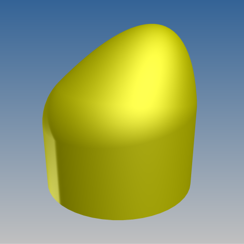

It is of only limited use, but it is possible to achieve some quite interesting results - see last two pictures.
