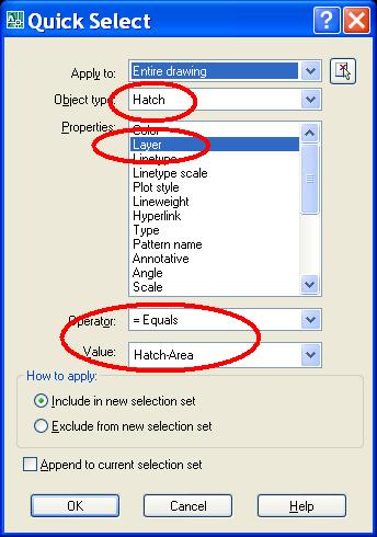

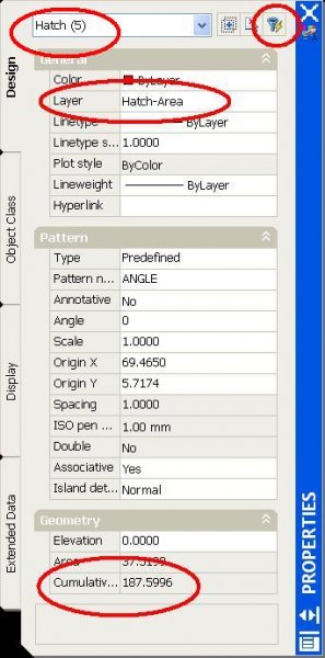

Does anyone already have a lisp that will select all the hatch on a layer and return the total area of hatch and the layer name. Possibly export it to excel.
Thanks.
you could try CADTools from www.glamsen.se
I'm not sure if it will return a total area, but that can be achieved with minimal effort; as long as you can get the results in excel (which is possible, as you can export the results to a .csv file)
